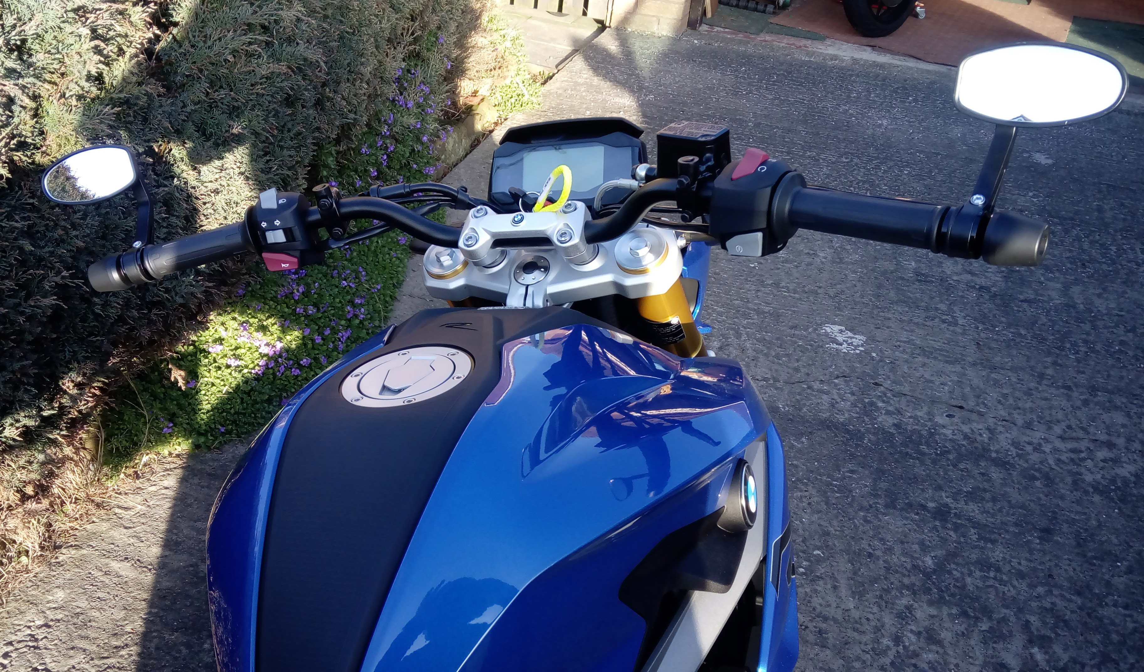

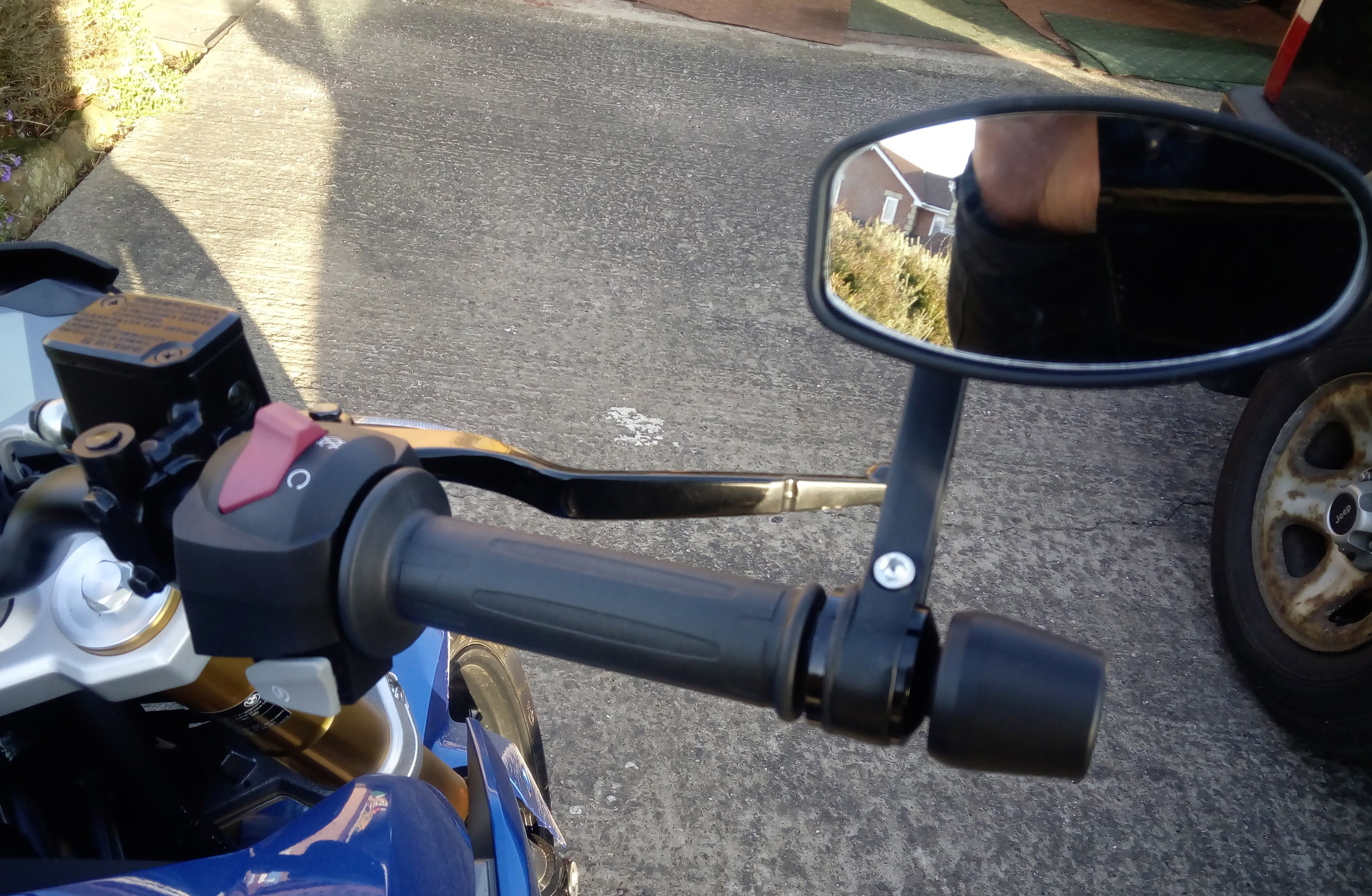

Today I installed these mirrors.
They are small ,cheap and not bad quality.
My original mirrors became loose.
They cost £9.95 (11.30 euros) plus p+p
Longer bolts are necessary
I bought 8mm x 75mm
The aluminium mirror body bolt holes will need drilling to 8mm
Easy as it is aluminum
